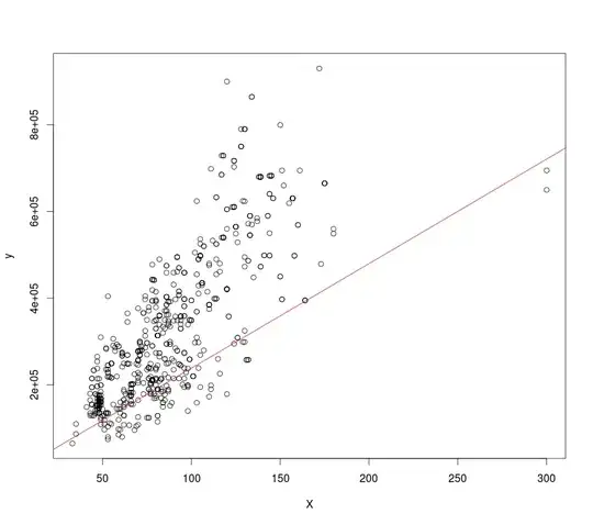

  • also I tried to use the function pcls in order to put some constraints on the coefficients, but this method gave very bad results. In the plot Y = price and X = livingArea. as you can see, the regression line isn't correct. enter image description here

price ~ livingArea
This is how the plotted data looks like. LivingArea is the only non-dummy variable.

I'm running the regression without intercept, because if all the characteristics of a real estate = 0, then of course it'S price = 0. Nobody would pay for an apartment with 0m². enter image description here but it seems that the regression line where it was used an intercept (blue) looks far more better than the regression line without intercept (green). I can't understand why it is so. and why doesn't the regression line without intercept start at the point (0,0)?

  • In the plot I draw only the regression line of the linear regression price~log(livingArea). Almost always I get an intercept bigger than half of the other coefficients. From business view I can't understand the need of an intercept, because I do model the area of the lot in a variable (propertyArea). So if all charcteristics are 0 (including the size of the lot) there will still be a price. – Paul Jun 17 '15 at 15:38

  • @F.Tusell: I added a plot price ~ livingArea. In this data set livingArea is the only non-dummy variable. The thing is that I can't (don't know how to) substitute the dummy variables with something else. – Paul Jun 15 '15 at 07:44
  • The price ~ livingArea looks as expected. I do not understand the rest of your comment. R will take care of the dummy (qualitative?) variables. You only have to define them as factors. I assume you are doing that. – F. Tusell Jun 15 '15 at 07:55

  1. Use intercept in your model. This is very strong assumption, that when all variables would equal 0, then predicted price should be zero and it is not required, especially, that such a real estate would not appear in a train or test data set. Even if it is true, that real estate with all characteristics equal to zero should have price equal to zero, it require assumption, that your model control all factors of estate price, which is rather false. If you think it is so obvious that only real estate with all characteristics equal to zero should have price equal to zero, how much would you pay for real estate with 5m squared area? Because I would still be able to pay zero dollars for such an estate. Am I unreasonable or this assumption is unreasonable?
  2. Use semi-logarithmic regression, that is predict logarithm of dependant variable. When you use normal linear regression, it is like assuming, that total value of estate is equal to sum of value of every single characteristic. This can be wrong assumption. I think, that for example, if estate is in quiet area it increases the value of estate by x%, let's say by 30%, no by x\$, not by certain fixed amount of dollars. That is however, what your model is assuming. It is unreasonable to assume, that values of two estates, that one of them have 100 m and second have 10000 m would be increased by the same amount of dollars, let's say by 10000$. It rather would be increased by certain percentage. Use semi-logarithmic model, by that your model will assume, that final value of estate can be reduced to multiplication of every of its properties. It usually works better in such a situations, and it is standard way of proceeding in real estate value model (look in literature, don't try to invent a wheel).
  3. Try to add other terms to your model: for example squares of variables and their interactions.
  4. Investigate outliers. At least two points looks like outliers, try to figure out what they are, and why they have strange variable values. Maybe you can find error in this data or you can add some feature or interactions to capture such cases.
