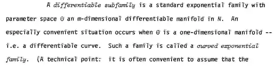

Also, I've learned that this is a member of the curved exponential family, a further generalization of the exponential family.
