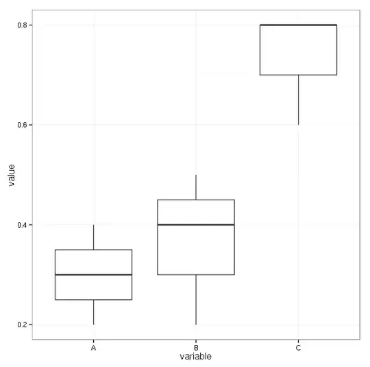

You can arrange your data as:
  PatientId variable value
1         1        A   0.2
2         2        A   0.3
3         3        A   0.4
4         1        B   0.5
5         2        B   0.4
6         3        B   0.2
7         1        C   0.8
8         2        C   0.6
9         3        C   0.8
and calculate means and sd:
> aggregate(value~variable, mm, mean)
  variable     value
1        A 0.3000000
2        B 0.3666667
3        C 0.7333333
> aggregate(value~variable, mm, sd)
  variable     value
1        A 0.1000000
2        B 0.1527525
3        C 0.1154701
and perform anova to see if the difference is significant. An error code will be needed since patients are common to different symptoms:
> summary(aov(value~variable+Error(PatientId/variable), mm))
Error: PatientId
          Df   Sum Sq  Mean Sq F value Pr(>F)
Residuals  1 0.001667 0.001667
Error: PatientId:variable
         Df Sum Sq Mean Sq
variable  2 0.2862  0.1431
Error: Within
variable   2 0.10381 0.05190   5.496 0.0993 .
Residuals  3 0.02833 0.00944
Signif. codes:  0 ‘***’ 0.001 ‘**’ 0.01 ‘*’ 0.05 ‘.’ 0.1 ‘ ’ 1
and do pairwise t-tests to find the differences:
> pairwise.t.test(mm$value, mm$variable)
        Pairwise comparisons using t tests with pooled SD
data:  mm$value and mm$variable
  A     B
B 0.537 -
C 0.016 0.023
P value adjustment method: holm
Following graph will show the distribution:
Hope this is of some help.
