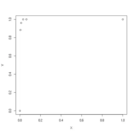

I have following simple X and Y vectors:
> X
[1] 1.000 0.063 0.031 0.012 0.005 0.000
> Y
[1] 1.000 1.000 1.000 0.961 0.884 0.000
> plot(X,Y)
I want to do regression using log of X. To avoid getting log(0), I try to put +1 or +0.1 or +0.00001 or +0.000000000000001 :
> summary(lm(Y~log(X)))

The output is different in all cases. What is the correct value to put to avoid log(0) in regression? What is the correct method for such situations.
Edit: my main aim is to improve prediction of the regression model by adding log term, i.e.: lm(Y ~ X + log(X))

The smaller the constant is that you add the larger the outlier is that you will create: enter image description here
So it is hard to justify any constant here. You might consider a transformation that has no problem with 0s, for example a third order polynomial.
