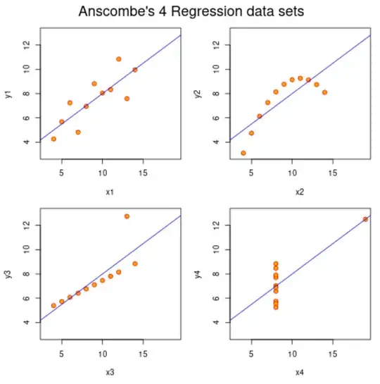

Correlation is not sufficient to describe the distribution of the datapoints. You would need the full distribution in order to make predictions about the distribution of $y_{n+1}$ given $x_{n+1}$.
Anscombe's quartet is a good example of the different types of relationships that you can have while the correlation is the same. In all the four images below the correlation is the same 0.816
Anscombe's quartet
