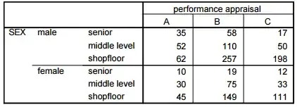

I'm doing a loglinear analysis of the following data.
Performance appraisal
Male is coded as 1, Female as 2. Senior workers are coded as 1, middle level as 2, and shopfloor as 3. A is coded as 1 and is the most positive appraisal. B is coded as 2 and is intermediate, while C is coded as 3 and represents the worst possible appraisal.

The odds of a man in $\rm{position}=3$ being $\rm{appraise}=1$ vs otherwise is $\frac{62}{257 + 198}=0.13$ to 1
The odds of a woman in $\rm{position}=3$ being $\rm{appraise}=1$ vs otherwise is $\frac{45}{149+ 111}=0.17$ to 1
The odds ratio is then $\frac{62 * (149+111)}{45 * (257+198)} = \frac{0.13}{0.17}=0.78$
