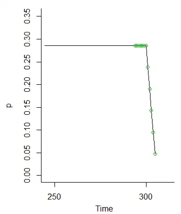

So here's the first 50-odd values (the first 25 values marked with circles). At each $t$, the value on the y-axis represents the probability that accumulated in the hindmost cell before we rolled it forward into the next 6 cells.
As you see it smooths out (to $1/\mu$, the reciprocal of the mean of the number of steps each die roll takes you) quite quickly and stays constant.
And once we hit $M$, those probabilities drop away (because we're not putting the probability for values at $M$ and beyond forward in turn)
So the idea that the values at $M-1$ to $M-6$ should be equally likely because the fluctuations from the initial conditions will get smoothed out is clearly seen to be the case.
Since the reasoning doesn't depend on anything but that $M$ is large enough that the initial conditions wash out so that $M-1$ to $M-6$ are nearly equally probable at time $\tau-1$, the distribution will be essentially the same for any large $M$, as Henry suggested in comments.
