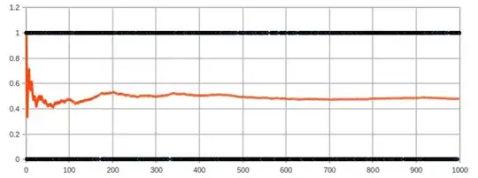

I read out the event counter second-wise, every black $1$ is a counted event (new events over time, see the plot below).
During the measurement I am estimating the event rate, so as more statistics is accumulated, mean event rate (red) should asymptotically become more accurate.
dyn_mean1
As one can see, the mean value oscillates around true value of 0.5,
dyn_mean2
even after one order of magnitude more events collected.
Practical question: How can one calculate the number of events needed to estimate the mean value to a maximum error ($0.5\pm \sigma$)? - answered (?) here

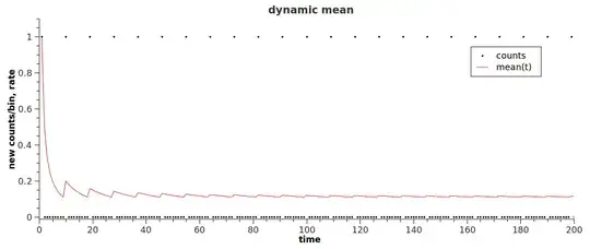

Addendum: Idealized first approximation - every 10th event is non-zero: dyn_mean_reg1
May be this curve is superimposed with the realer-life example above, is any techniques of partitioning in arbitrary functions applicable here?

  • See my comment to the referenced question. For the theoretical question, read about Brownian motion and random walks. – whuber Aug 19 '11 at 22:53
This is an answer to your first "theoretical" question Can this oscillation be described analytically? Can you suggest further reading?
If I understand your question correctly, you are in the situation of independent identically distributed random variables with finite variance $\sigma^2$. In this case the law of the iterated logarithm applies which tells you that you should expect the difference between estimated mean and mean to oscillate between $-\sigma$ and $+\sigma$, if you normalize it by dividing by $\sqrt{2n\log{\log{n}}}$.
