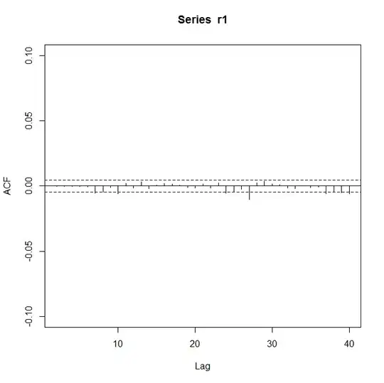

As @Dan requested here are the plots

ACF of the residuals after the ARMA estimation enter image description here

  • @CagdasOzgenc I don't really get what you mean. I have added the ACFs of the residuals and their squares after the ARMA GARCH estimation. My point is that according to the ACF of post ARMA estimation, there is a lot of autocorrelation in the squares. Hence I have employed the GARCH which however didn't improve the situation as it is visible in the post ARMA-GARCH residuals – m3div0 Mar 27 '15 at 18:48
    Divide each residual with its corresponding standard deviation i.e. r(t)/s(t). Then run the ACF. – Cagdas Ozgenc Mar 27 '15 at 19:01
  • Ok, that made some difference. There is now no autocorrelation in the residuals and in the squared standardized residuals only the first lag is significant in both ACF and PACF which is still weird since I have used GARCH(1,1). Moreover, can you please explain why do we use the standartized values instead of plain ones? – m3div0 Mar 27 '15 at 21:24
    Residuals contain the time-varying variance as a multiplicative factor. If you don't divide them by square-root of estimated variance their squares remain autocorrelated (by definition of GARCH). ARMA part takes care of only the mean. The residual autocorrelation in the first lag, I presume is due to ARMA(6,0), which is probably wrong. If the signal is some stock price then ARMA(1,1)-GARCH(1,1) or ARMA(0,1)-GARCH(1,1) will do better according to my experience. – Cagdas Ozgenc Mar 27 '15 at 21:46
  • That makes sense, thank you very much! I'll try to evaluate more different specifications of ARMA, hopefully it will help. – m3div0 Mar 27 '15 at 22:10
