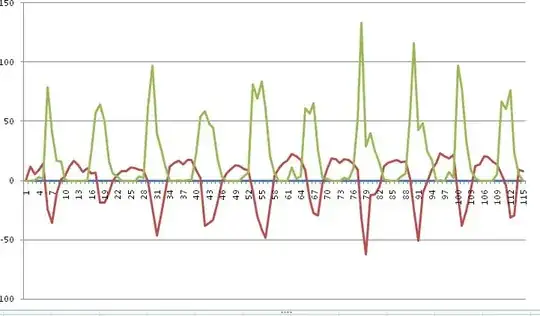

I have two time series A, B. Both are seasonal and B primarily is A driven( other temporal causes may exist). graphs
B-Red, A- Green
I want to calculate lag of red series with respect to green as clearly, it exists.
Now, I am taking Spearman's correlation at different lags and choosing the max to decide the lag which gives satisfying answer.
To confirm the confidence in lag, I am trying entropy based methods.
I tried conditional entropy and here are the results.
   lag C-Entropy   corr
    0 1.0820745 -0.735406343
    1 0.8978593 -0.830377446
    2 1.1218689 -0.689623230
    3 1.2412857 -0.336204576
    4 1.2985196  0.054672496
    5 1.2727747  0.485228731
    6 1.1027205  0.771465042
    7 0.9616463  0.839862100
    8 1.1296509  0.677166842
    9 1.2805970  0.396034333
    10 1.3420290  0.005832166
I am confused over this.
Correlation is highly negative while entropy is down?
R code for entropy calculation:
   B_d= discretize(B)
   A_d= discretize( A)
   H <- condentropy(B_d, A_d, method = "mm")
Also, Any suggestions for entropy based methods or options which can be helpful for this situation. I have to find lags over several such pairs and need another metric to evaluate lag calculated from correlation.

I think that you are quite wrong in making a way too fast conclusion that it is not possible to use entropy as a similarity measure. Indeed, entropy can be used as a measure of similarity, both in general (Korhonen & Krymolowski, 2002) as well as for autocorrelated processes, such as time series (Liu, Pokharel & Principe, 2006). In particular, Korhonen and Krymolowski, among other similarity measures, describe cross-entropy, which might be useful in your case. Moreover, Liu et al. describe cross-corentropy, which is also referred to simply as correntropy - an information theory-based similarity measure, which extends auto-correntropy function to two random variables.
As an additional aid, you might find helpful the following related answers of mine: on performing time series analysis in R, on time series classification and clustering and (more) on dynamic time warping (disregard the focus on the irregular time series - the information is helpful in general).

Apparently, Entropy doesn't give similarity measure as I was expecting but dependence measure. So when two series are having opposite peaks and opposite curve shapes in the same bin, entropy is low (as expected) and correlation is highly negative.
So my understanding was wrong in using conditional entropy as similarity measure as an alternative to correlation. It is a dependence measure. Please correct me If I got it wrong.
