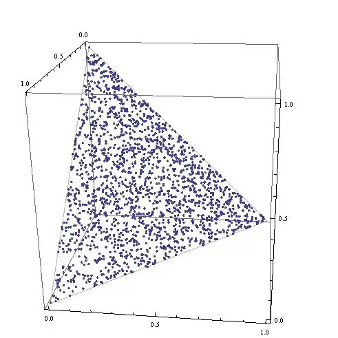

3D point plot
This 3D point plot shows the results of 2000 iterations of this algorithm for $n=3$. The points are confined to the simplex and are approximately uniformly distributed over it.

  • Is this an algorithm for sampling from Dir(1)? – Chris Aug 10 '11 at 10:48
    @Chris If by "Dir(1)" you mean the Dirichlet distribution with parameters $(\alpha_1, \ldots, \alpha_n)$ = $(1,1,\ldots,1)$, then the answer is yes. – whuber Aug 10 '11 at 12:04
    (+1) One minor comment: The intuition is excellent. Care in interpreting (a) may need to be taken, as it seems that the "linear transformation" in that part is a random one. However, this is easily worked around at the expense of additional formality by using exchangeability of the generating process and a certain invariance property. – cardinal Aug 10 '11 at 12:25
    More explicitly: For distributions with a density $f$, the density of the order statistics of an iid sample of size $n$ is $n! f(x_1)\cdots f(x_n) 1_{(x_1 < x_2 < \cdots < x_n)}$. In the case of $f = 1_{[0,1]}(x)$, the distribution of the order statistics is uniform on a polytope. Taken from this point, the remaining transformations are deterministic and the result follows. – cardinal Aug 10 '11 at 12:47
    @cardinal That's an interesting point, but I don't think it matters, although you're right that additional details could help. The swaps (actually reflections, qua linear transformations) are not random: they are predetermined. In effect, $I_{n-1}=[0,1]^{n-1}$ is carved into $(n-1)!$ regions, of which one is distinguished from the others, and there's a predetermined affine bijection between each region and the distinguished one. Whence, the only additional fact we need is that a uniform distribution on a region is uniform on any measurable subset of it, which is a complete triviality. – whuber Aug 10 '11 at 12:51
    @whuber: Interesting remarks. Thanks for sharing! I always appreciate your insightful thoughts on such things. Regarding my previous comment on "random linear transformation", my point was that, at least through $\mathbf{x}$, the transformation used depends on the sample point $\omega$. Another way to think of it is there is a fixed, predetermined function $T: \mathbb{R}^{n-1} \to \mathbb{R}^{n-1}$ such that $\mathbf{w} = T(\mathbf{x})$, but I wouldn't call that function linear, though it is linear on subsets that partition the $(n-1)$-cube. :) – cardinal Aug 10 '11 at 16:48
    @cardinal That's correct (and so I have been careful not to call T linear!): the function is piecewise affine. We're really just applying the standard formula for a change of variable, paying attention to the fact that the mapping is not one-to-one, and exploiting the constancy of the Jacobians involved. But, having made those observations, it's clear we don't have to actually compute the Jacobians. – whuber Aug 10 '11 at 17:04
