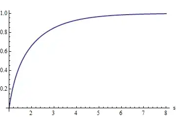

The range of $f(s) = \zeta(2s)/\zeta(s)$ is the interval $(0,1)$, as this partial graph indicates:
Figure of the zeta ratio
Selecting $\lambda$ such that $1-a \lt \lambda \lt 1$, pick $s \gt 1$ for which $f(s) = (1-a)/\lambda$; that is, $a = 1 - \lambda f(s)$. This constructs an $X$ with all the stated properties.
