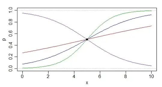

Consider the following simple situation: a logistic regression model, $P[Y=a|x]=\frac{\exp(\alpha+\beta x)}{1+\exp(\alpha+\beta x)}$ or equivalently $\text{logit}(P[Y=1|x])=\alpha+\beta x$, where we only have data at one x-value, say x=5; for which we have two binary outcomes, $y_1=0$ and $y_2=1$; the proportion of $1$'s at $x=5$ is $\frac{1}{2}$.
An infinite number of different logistic functions can be fitted through that point:
Indeed, any logistic curve which has $\beta = -\alpha/5$ will go through the point. With no data at all, any point in $\mathbf{R}^2$ would be possible. By adding a point $(x_1,y_1)$, a perfect fit can be obtained by any point in the one-dimensional space $\alpha+x_1\beta=\text{logit}(y_1)$ (if we added information at a second value of $x$, the subspace in which $(\alpha, \beta)$ could lie would reduce again, to 0-dimensions (that is - usually - data at two x-values are enough to determine two parameters).
