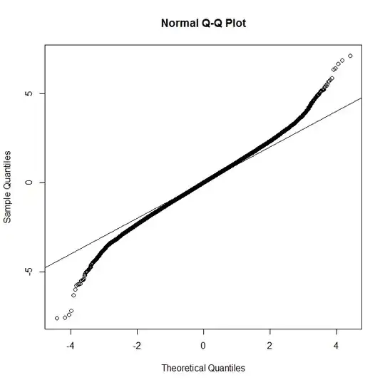

Here is a little simulation. We simulate 100,000 ARMA(1,1) time series with 11 observation each, all with AR and MA coefficients of 0.5. In each case, we fit a model on the first 10 observations. We use arima(), not auto.arima(), since for now we do not want to deal with misspecified models; instead, we force the fitted model to have the correct ARMA(1,1) structure. We forecast a single value out and store the error. Finally, we create a normal q-q-plot of the errors.

qqnorm(error)
abline(a=0,b=1)
qqplot
The plot clearly shows that the errors are heavier-tailed than the normal distribution. The reason is that we do not take parameter estimation uncertainty into account.

This looks much more normal. Indeed, both plots together look very much like what we would expect from a standard OLS model: a heavy-tailed forecast error distribution for smaller numbers of observations (that is, a t distribution), which approximates a normal distribution as the number of observations increases.
So, even if my textbooks are vague on this point, I strongly suspect that the correct predictive distribution does involve a t distribution, with degrees of freedom related to the number of observations. And if the number of observations increases, we can safely treat the t distribution with large df as a normal distribution.
