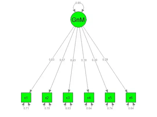

I've also attached the graphical model below for problematic.myfit1:
Offending model

Think of the scale of GnM. It is latent so it does not have a natural scale like meters (inches), euros (yen), etc. Instead we need to give it a scale by telling it when it is 0 and what a unit of increase is. In your original model you set GnM to 0 when all the indicators are 0, and by setting the loading of x1 to 1, you are borowing the unit from x1. So a unit increase in GnM is equivalent to a unit increase in x1. When you set the loading of x1 free, what is the unit of GnM? We don't know, so it is unidentified. A common way to solve that is to set the variance of GnM to 1.
