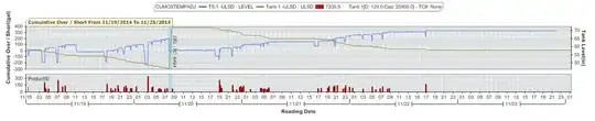

Our business problem is that we have these charts that have 2 or more lines (series) on them. Depending on what the lines are doing over time (increase / decrease, speed of increase / decrease) (and they vary independently), and how they vary with respect to each other, we have human analysts working here who can look at those charts and say "normal operation" or one of several types of exception conditions. They do this informally but quite accurately.
So, my questions is, what kind of neural network is this, that can classify this multiple time series data?

  • @gung, actually it's more general than that. The human analyst can look at the above graph and classify it as one of about 8 error conditions, or normal. They are not looking at lines individually, but the graph as a whole. Several things are happening in the system at once and this time series data is plotted and the interplay between these lines and what the lines are doing form a classification.
    Kinda like if you saw a graph of taxes going up and income going down, you would classify that as "people in this country at this time were probably unhappy".

This is called sequence classifiation problem. The simplest ANN to do that is probably time-delay neural network (TDNN) that takes vector of current values together with N vectors of data values at previous time steps and predict current tag (one of 9 possible conditions in your case). So typical setup to try first can consist of input vectors array, one hidden layer and one output softmax layer. You sequence will need to be hand-labeled to obtain training data of course. This kind of NN is easy to implement and there are ready to use .NET libraries so you can avoid interfacing things with Mathematica if you want.
