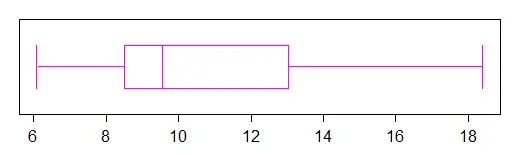

Tukey modifies this "five-number summary" version of the boxplot a little - he draws the whiskers only out to the most extreme points inside 1.5 x the width of the box above and below the box-ends, leaving the points outside them marked individually (in fact he distinguishes those into two groups, but let's not worry about that right now).
For our data there are no points outside those limits, so we get the previous display, which is essentially that five number summary:
This summary tells us a little about the distribution of the data - its center, spread and range. It's possible to discern something of how skewed and heavy tailed the data may be as well, but details like multimodality are completely lost.
We can see a variety of things, for example -- the median is around 9.5, that half the data lie between about 8.5 and 13, the data are mildly right skew, and that the data range from just above 6 to somewhat over 18.
