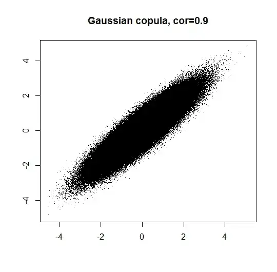

Telling whether the copulas exhibits tail dependence is not hard in extreme cases: what matters is whether the (two) variables appear behave more closely in the corners of the graph than in the center.
The Gaussian copula does not have tail dependence - though the random variables are highly correlated, there seems to be no special relationship any of the variables reaches large values (in the corners of the chart). Gaussian copula with normal marginals and correlation of 0.9
The absence of the tail dependence becomes apparent when the plot is compare to the plot of simulations from the same marginals but with T-2 copula.
T-copulas have the tail dependence and the dependence increases with correlation and decreases with the number of degrees of freedom. If more points were simulates, so that larger portion of the unit square was covered, we would almost see the points a thin line in the upper-right and lower-left corners. But even on the chart, it is apparent that in the upper-right and lower-left quadrants - i.e. where both variables attain very low, or very high values - the two variables appear to be even more closely correlated than in the body.

PS: Technically speaking, the pictures show multivariate distributions generated from the copulas and normal marginals.

    Could you further explain how your graphs show tail dependence. How would you explain it if you were explaining it to a person with limited stats background – Jim Jan 30 '15 at 00:30
  • Thank you, could you also define u? u is undefined in your equation – Millemila Aug 04 '20 at 15:02
  • the graphs shown are for the raw data, and therefore are not good for visualizing tail dependence. Instead, it's better to look at the transformed data (the raw data transformed into uniform distributions prior to being copulized), whose data points fill the graph to the edge, allowing tails to be seen. Higher density in the lower left and upper right of those graphs (of the transformed uniforms) will indicate tail dependence – develarist Aug 30 '20 at 14:37
  • @Jim Here are bivariate plots of transformed (uniform) data where you can actually see tail dependence in the corners, unlike plots of raw data: https://raw.githubusercontent.com/MaximeJumelle/pycopula/master/resources/simulation_gaussian.png and https://stats.stackexchange.com/questions/472074/what-does-positive-gaussian-copula-dependency-describe – develarist Aug 31 '20 at 13:05
