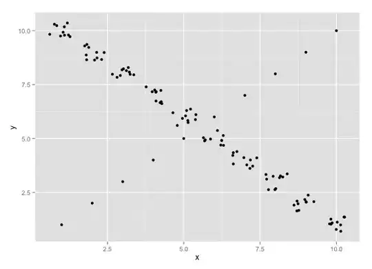

I'll give a visual example, using jitter to make clear what a regression actually "sees." First, here's a dataset consisting of one ascending and one descending sequence:
balanced plot
It's symmetrical, so the line of best fit would just be flat through 5.5. But what happens if I replicate the descending sequence 10 times, and use jitter to make the scatterplot look visually like it looks like to the underlying algorithm?
jittered plot
Now it looks a lot more like the ascending sequence is just outliers, right? And the trend line is clearly decreasing. (It works exactly the same way with logistic regression, it's just harder to make it clear from a plot.)
