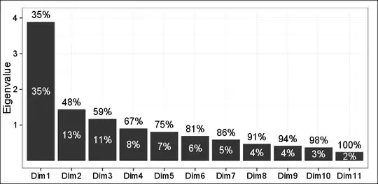

I have a dataset with 11 variables and PCA (orthogonal) was done to reduce the data. Deciding on the number of components to keep it was evident for me from my knowledge about the subject and the scree plot (see below) that two principal components (PCs) were enough to explain the data and the remaining components were only less informative.
Scree plot with parallel analysis: observed eigenvalues (green) and simulated eigenvalues based on 100 simulations (red). Scree plot suggests 3 PCs, whereas parallel test suggests only the first two PCs.
As you can see only 48% of the variance could be captured by the first two PCs.
Plotting observations on the first plane made by the first 2 PCs revealed three different clusters using hierarchical agglomerative clustering (HAC) and K-means clustering. These 3 clusters turned out to be very relevant to the problem in question and were consistent with other findings as well. So except the fact that only 48% of variance was captured everything else was tremendously fine.
One of my two reviewers said: one cannot rely much on these findings as only 48% of variance could be explained and it is less than required.

Regarding your particular questions:
Is there any required value of how much variance should be captured by PCA to be valid?
No, there is not (to my best of knowledge). I firmly believe that there is no single value you can use; no magic threshold of the captured variance percentage. The Cangelosi and Goriely's article : Component retention in principal component analysis with application to cDNA microarray data gives a rather nice overview of half a dozen standard rules of thumb to detect the number of components in a study. (Scree plot, Proportion of total variance explained, Average eigenvalue rule, Log-eigenvalue diagram, etc.) As rules of thumb I would not strongly rely on any of them.

Can anybody judge on the merit of the whole analysis just based on the mere value of the explained variance?
In general one should not do that. Do not think that your reviewer is a bastard or anything like that though; 48% is indeed a small percentage to retain without presenting reasonable justifications.
