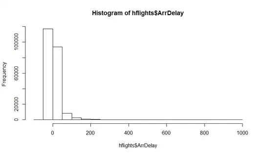

In Information Theory the typical way to quantify how "close" one distribution to another is to use KL-divergence
Let's try to illustrate it with a highly skewed long-tail dataset - delays of plane arrivals in the Houston airport (from hflights package). Let $\hat \theta$ be the mean estimator. First, we find the sampling distribution of $\hat \theta$, and then the bootstrap distribution of $\hat \theta$
Here's the dataset:
The true mean is 7.09 min.
First, we do a certain number of samples to get the sampling distribution of $\hat \theta$, then we take one sample and take many bootstrap samples from it.
For example, let's take a look at two distributions with the sample size 100 and 5000 repetitions. We see visually that these distributions are quite apart, and the KL divergence is 0.48.
But when we increase the sample size to 1000, they start to converge (KL divergence is 0.11)
And when the sample size is 5000, they are very close (KL divergence is 0.01)
This, of course, depends on which bootstrap sample you get, but I believe you can see that the KL divergence goes down as we increase the sample size, and thus bootstrap distribution of $\hat \theta$ approaches sample distribution $\hat \theta$ in terms of KL Divergence. To be sure, you can try to do several bootstraps and take the average of the KL divergence.

  • @AlexeyGrigorev I just want to make sure that I understand your figures. So the 1st figure is our 'Population' right? In the 2nd figure the 'true' is obtained from fix sample size $N=100$ and draw with replacement from the 'Population' 5000 times right? And the bootstrap in 2nd figure is obtained by randomly pick a sample with $N=100$ from the 'Population', then resampling from this specific sample for 5000 times right? The 3rd and 4th figures are similar but with $N=1000,5000$ and still fixed the number of bootstrap to be 5000 right? – KevinKim Jan 13 '15 at 16:22

  • @ChenJin yes that's right – Alexey Grigorev Jan 13 '15 at 16:54
