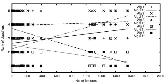

The independent variable on the x-axis represents the number of features and the dependent variable on the y-axis represents the rank if classification algorithms when compared in their performance. Now I have some algorithms that are comparable on average, but what I want to say with my plot is something like: "While classifier A gets better the more features are present, classifier B is better when less features are present"
Edit 2 to include my plots:
Ranks of algorithms plotted versus the number of features enter image description here
Ranks of algorithms plotted versus the ranked number of features enter image description here

If you're not displaying anything but rank(Y) vs X, I think I'd avoid using lines on the plots; as far as I can see they don't convey much of value above the correlation coefficient. And already said you're only interested in the trend.

  • Yes, it is of value to, but more in a general sense. I also agree that the "wrongness" comes from the difficulty to interpret the plot. I fear that people will always assume that I want to predict the rank from the feature, even if I state that I only want to show the trend. – Sentry Jan 11 '15 at 12:37
  • Looking at your plots --- you show ranks, but do you have original measures of performance on which ranks were based? – Glen_b Jan 11 '15 at 12:44
  • Yes, I do, but they can't be used here, believe me. The focus of my study is on comparing the algorithms using the Friedman test, which ranks them. There multiple data sets with highly different performance ranges, so only the comparison between them is interesting here. – Sentry Jan 11 '15 at 13:43
  • If you're not displaying anything but rank(Y) vs X, I think I'd avoid using lines on the plots; as far as I can see they don't convey much of value above the correlation coefficient. – Glen_b Jan 12 '15 at 00:03
  • You're right, thank you for the very detailed answer. It really is the slope that is interesting, I see that now. I'll accept your answer and add that statement to it. – Sentry Jan 12 '15 at 09:14
