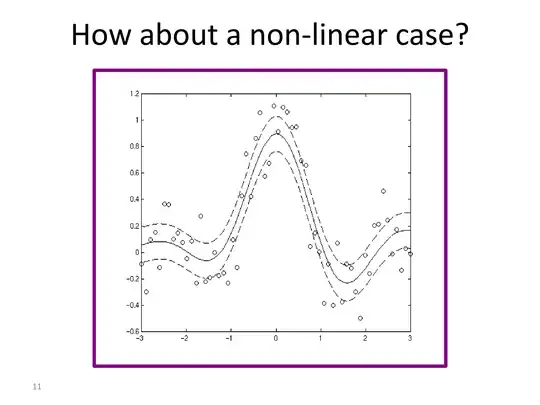

Regarding support vector regression (SVR), I find these slides from http://cs.adelaide.edu.au/~chhshen/teaching/ML_SVR.pdf (mirror) very clear:
enter image description hereenter image description here
