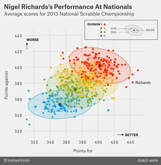

I have noticed that many "state of the art" plotting packages and themes and many distinguished data folks use grey background for their plots. Here are several examples:
ggplot2:
Nate Silver's fivethirtyeight.com:
While in the first example above (ggplot2), one may argue that using grey background reduces the ink needed for grid lines, this is certainly not the case with the second case. What are the advantages of using grey background, as opposed for white or transparent one?

    @ttnphns I like the analogy. Hadley Wickham said of ggplot's background: "The grey background gives the plot a similar colour (in a typographical sense) to the remainder of the text, ensuring that the graphics fit in with the flow of a text without jumping out with a bright white background. Finally, the grey background creates a continuous field of colour which ensures that the plot is perceived as a single visual entity." He also justified gridlines on the basis that they can easily be "tuned out". – Silverfish Jan 06 '15 at 22:03

He also justified the white gridlines on the basis that they can easily be "tuned out". I agree with Dianne Cook in the comments that this lets the data stand out above the gridlines, reducing visual clutter. The white gridlines are one advantage of a slightly darker background — interestingly, Tufte generally avoids gridlines where they are not necessary (they do not count as "data ink") but on some grey bar charts overlays white gridlines. In some ways this is a similar effect to ggplot2, but actually puts the gridlines in the foreground, giving the bars a "striped" appearance. A particular disadvantage of this is that you can't see the next-highest gridline above a bar, making it hard to visually interpolate how high a bar is numerically.

As long as the background is light enough to provide good contrast with the data marks, it's mostly a matter of aesthetics whether it's white or light gray. While the background color is "ink" in some sense, I don't think it counts as "ink" logically. There is no proportional distraction from a solid field of light gray.
Conversely, the grid lines count as logical "ink" in both cases. Even though the white grid lines would consume no ink to print, they still break up the background and create extra visual processing work. I'd say the 538 grid lines take less logical ink because they have less contrast.

  • "I'd say the 538 grid lines take less logical ink..." -- I agree, I find the default ggplot2 gridlines extremely distracting. In the ggplot2 example at the top of the OP's question, my eyes are drawn to the gridlines rather than the data. – Adrian Mar 09 '16 at 13:23
