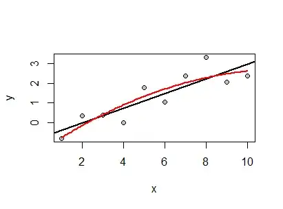

Example 1
Let me illustrate with randomly generated data. Here is a plot of ten $(x_i,y_i)$ points. On it I have superimposed the OLS fit for model $(1);$ that is, the graph of the function $x\to \hat\beta_0 + \hat\beta_1 x^2.$
Figure 1: xy scatterplot of data
The correlation coefficient is $0.873:$ pretty high. But does it, or does it not, indicate a linear relation? Let's fit model $(2).$ Here is a summary of the standard OLS output.
Coefficients:
            Estimate Std. Error t value Pr(>|t|)
(Intercept)  1.08750    0.78832   1.380   0.2102
x           -0.30873    0.32923  -0.938   0.3796
I(x^2)       0.07142    0.02917   2.449   0.0442 *
The t-test for the quadratic term yields a p-value of $0.0442$ (shown at bottom right). If you take $5\%$ to be your level of significance, then because $0.0442 \lt 5/100$ you would take this to be evidence of nonlinearity.
The ANOVA table compares the fits of models $(1)$ and $(2)$ directly.
Model 1: y ~ x
Model 2: y ~ x + I(x^2)
  Res.Df    RSS Df Sum of Sq      F Pr(>F)
1      8 5.8381
2      7 3.1446  1    2.6934 5.9956 0.0442 *
It does this by comparing the "residual sums of squares" RSS in the two models. Note that its p-value is the same as before: it's in this sense that this test is equivalent to the preceding one.
Here is a graph of the quadratic fit in red:
Figure 2
The preceding tests have established that the red curve is a sufficiently good improvement over the black line, as a description of the overall $(x_i,y_i)$ relationship, that it may be the better model.
