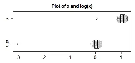

less affected by outliers
As a general claim, this is false. Consider low outliers in a predictor.
