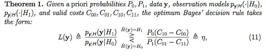

My background is mainly in machine learning and I was trying to learn what Bayesian Hypothesis testing meant. I am ok with the bayesian interpretation of probability and I am familiar with it in the context of probabilistic graphical models. However, what is confusing me is what the word "Hypothesis" means in the context of statistical inference.
I think I am mostly getting confused about the vocabulary that I am used to in machine learning vs what is normally used in statistics and inference.
In the context of supervised learning, I normally think of the hypothesis as the predictive function that maps examples to its labels i.e. $h:\mathcal{X} \rightarrow \mathcal{Y}$. However, it seems to me that the term hypothesis, in the readings that I am doing don't have the same meaning. Let me paste an extract of the readings I am reading:
If you read carefully it also says:
there is a different model for the observed data ...
were they use the word model. For me the word model makes me think of a set of functions were we select a specific predictive function. i.e. a hypothesis class of function. For example, $\mathcal{H_{d2}}$ could be the hypothesis class of quadratic functions (polynomial of degree 2). However, it seems to me that they use the word model and hypothesis as synonymous in this extract (where for me they are completely different words).
Then it goes on to mention that we can put priors to hypothesis (a completely reasonable thing to do in a bayesian setting):
$$p_H(H_m), \ \ \ \ \ m=\{0, 1, ..., M-1 \}$$
also we can characterize the data with a current hypothesis:
$$p_{y|H}( \cdot |H_m), \ \ \ \ \ m=\{0, 1, ..., M-1 \}$$
and update our current believes given some data (and Baye's rule):
$$p_{H|y}(H_m|y), \ \ \ \ \ m=\{0, 1, ..., M-1 \}$$
However, I guess I am more used to putting a bayesian estimate to a particular parameter (say $\theta$) from a hypothesis class rather than to the whole hypothesis class. Basically since it seems that these "hypotheses" are not the same hypotheses from the machine learning context that I am used to, it seems to me that these hypotheses are more similar to a specific $\theta$ parameter than to a hypothesis class.
At this point I was convinced that "hypothesis" meant the same thing as in the predictive function (parametrized by a parameter $\theta$, for example), but I think I was wrong...
To make my confusion even worse, later these same reading went ahead to specify a particular "hypothesis" to each training example that they observed. Let me paste an extract of what I mean:
the reason that this confuses me is that, if I interpret hypothesis as a parameter, then for me it makes no sense to specify a specific parameter for each sample value that we see. At this point I concluded that I really didn't know what they meant by hypothesis so I posted this question.
However, I didn't fully give up, I researched what hypothesis means in frequentist statistics and found the following khan academy video. That video actually makes a lot of sense to me (maybe you are a frequentist! :). However, it seems that they get a bunch of data (like some "sample set") and based on the properties of the sample set, they decide whether to accept or reject the null hypothesis about the data. However, in the Bayesian context that I am reading, it seems to me that for each data [point] vector that is observed, they "label it" with a hypothesis with the "Likelihood ratio test":
The way they are assigning hypothesis to each data sample, even seems like a supervised learning setting were we are attaching a label to each training set. However, I don't think that's what they are doing in this context. What are they doing? What does it mean to assign a hypothesis to each data sample? What is the meaning of a hypothesis? What does the word model mean?
Basically, after this long explanation of my confusion, does someone know what bayesian hypothesis testing means in this context?
If you need any clarification or anything to improve my question or so that the question makes sense, I am more than happy to help :)

Perhaps taking the example from your notes of a medical diagnosis will help. Say a patient can be either "normal" or in "hypertensive crisis".
We have prior information that only 1% of people are in hypertensive crisis. People in hypertensive crisis have systolic blood pressure that follows a normal distribution with mean=180 and sd=10. Meanwhile, normal people have blood pressure from a normal distribution with mean=120, sd=10. The cost of judging a person normal when they are is zero, the cost of missing a diagnosis is 1, and the cost due to side effects due to the treatment is 0.2 regardless of whether they are in crisis or not. Then the following R code calculates the threshold (eta) and likelihood ratio. If the likelihood ratio is greater than the threshold we decide to treat, if less than we do not:
#Prior probabilities
P0=.99 #Prior probability patient is normal
P1=1-P0 #Prior probability patient is in crisis
#Hypotheses
H0<-dnorm(x=50:250, mean=120, sd=10) #H0: Patient is normal
H1<-dnorm(x=50:250, mean=180, sd=10) #H1: Patient in hypertensive crisis
#Costs
C00=0 #Decide normal when normal
C01=1 #Decide normal when in crisis
C10=.2 #Decide crisis when normal
C11=.2 #Decide crisis when in crisis
#Threshold
eta=P0*(C10-C00)/ P1*(C01-C11)
#Blood Pressure Measurements
y<-rnorm(3, 150, 20)
#Calculate Likelihood of Each Datapoint Given Each Hypothesis
L0vec=dnorm(x=y, mean=120, sd=10) #Vector of Likelihoods under H0
L1vec=dnorm(x=y, mean=180, sd=10) #Vector of Likelihoods under H1
#P(y|H) is the product of the likelihoods under each hypothesis
L0<-prod(L0vec)
L1<-prod(L1vec)
#L(y) is the ratio of the two likelihoods
LikRatio<-L1/L0
#Plot
plot(50:250, H0, type="l", col="Green", lwd=4,
     xlab=" Systolic Blood Pressure", ylab="Probability Density Given Model",
     main=paste0("L=",signif(LikRatio,3)," eta=", signif(eta,3)))
lines(50:250, H1, col="Red", lwd=4)
abline(v=y)
#Decision
if(LikRatio>eta){
  print("L > eta  ---> Decision: Treat Patient")
}else{
  print("L < eta  ---> Do Not Treat Patient")
In the above scenario the threshold eta=15.84. If we take three blood pressure measurements and get 139.9237, 125.2278, 190.3765, then the likelihood ratio is 27.6 in favor of H1: Patient in hypertensive crisis. Since 27.6 is greater than than the threshold we would choose to treat. The graph shows the normal hypothesis in green and hypertensive in red. Vertical black lines indicate the values of the observations.
