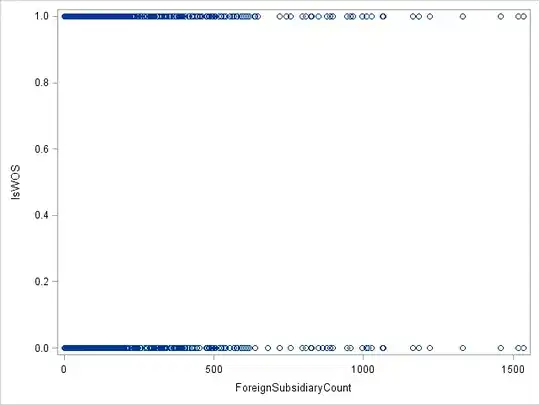

Edit: how can the best transformation be identified when the DV is binary?
When attempting to find the best transformation for a continuous IV in relation to a binary DV, how is this best done? For a continuous DV in e.g. OLS regression, this is possible visually, but when attempting this for a binary variable, it obviously becomes difficult (see below).

  • @EdM Ok,so 'transforming to achieve linearity' means exactly transforming to obtain a more accurate model of the phenomenon modeled. The problem is now: how can i visually diagnose the relationship ton decide on the most accurate transformation when the DV is binary? a scatter plot makes no sense with a binary DV. – SuppaiKamo Dec 22 '14 at 18:27
    In R, the spineplot() function is a good way to start visualizing. With a numeric independent variable it displays a 'spinogram' of the relative frequencies of the binary DV outcomes for histogram-like groupings of the independent variable. Or you can do it yourself manually: break down your data into groups by Foreign Subsidiary Count, calculate the proportion of IsWOS for each group, and plot that against the mean or median value of Foreign Subsidiary Count for each group. – EdM Dec 22 '14 at 21:54

Use a smoother on the binary reponse to visually investigate the relationship: see Creating univariable smoothed scatterplot on logit scale using R. Taking the logit (or another link function where applicable) of the smooth allows you to assess its linearity on the appropriate scale. Note in plots like these you're looking at the marginal effect of the predictor along the abscissa & not taking into account confounding effects of other predictors.
Note that investigating transformations in this way & picking the "best" introduces an optimistic bias into model performance measures (when the model's fitted to the same data that suggested the transformation) which can't be incorporated into resampling validation procedures. An alternative approach would be to consider that the relationship between any simple transformation of "age of firm" and the logit of the response isn't the kind of thing that's going to be exactly linear, & to incorporate your uncertainty about its nature into the model-fitting process by representing "age of firm" with a polynomial or spline basis. That doesn't preclude transforming the predictor beforehand when this seems sensible given its distribution—often done to reduce the influence of observations in the right tail of a very skewed distribution.
