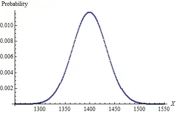

A similar (unoptimized) calculation for $n=400$ dice instead of $n=4$ took less than a half a second, supporting the contention that this is not a computationally demanding algorithm. Here is a plot of the main part of the distribution:

Since the minimum $K$ is highly likely to equal $1$ and the sum $X$ will be extremely close to having a Normal$(400\times 7/2, 400\times 35/12)$ distribution (whose mean is $1400$ and standard deviation is approximately $34.1565$), the mean must be extremely close to $1400-1=1399$ and the standard deviation extremely close to $34.16$. This nicely describes the plot, indicating it is likely correct. In fact, the exact calculation gives a mean of around $2.13\times 10^{-32}$ greater than $1399$ and a standard deviation around $1.24\times 10^{-31}$ less than $\sqrt{400\times 35/12}$.
