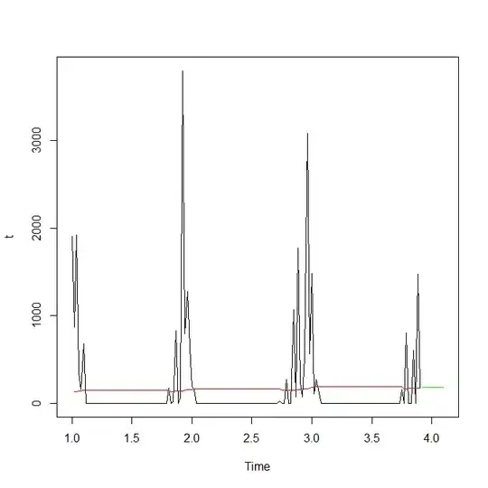

Here is your time series, with the in-sample fit in red and the forecast in green:
bar <- crost(t)
plot(t,xlim=c(1,4.1))
lines(ts(bar$frc.in,frequency=52),col="red")
lines(ts(bar$frc.out,frequency=52,start=c(3,49)),col="green")
Croston
Now, looking at your data v, Croston's method is quite obviously inappropriate. Although you do have many zeros, your time series is not intermittent in any meaningful sense. Instead, it is obviously seasonal, with periods of nonzero demand alternating with periods of zero demand in a yearly pattern.
