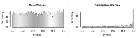

Below is an illustration of the impact on the distribution of p-values under identical population distributions with of a moderate level of ties$^\ddagger$ with sample sizes of 33 and 67 under the default settings in R (which for the Mann-Whitney uses the normal approximation with correct calculation of variance in the presence of ties for this sample size):
For the tests to work 'as advertized' under the null, these distributions should look close to uniform. As you see, the Mann-Whitney (at least when properly calculating the variance of the sum of the ranks under the presence of ties, as here) is indeed very close to uniform. Since (as we can see) for the Kolmogorov-Smirnov test the proportion of p-values below $\alpha$ will be much smaller than $\alpha$, the test is highly conservative, with corresponding effects on power. [If anything, the effect is somewhat stronger than I'd have anticipated.]
