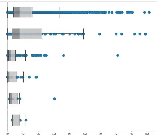

I have a data set shown as box-whisker graphs after disaggregating. See below.
I am wondering why Tableau (the product I am using) automatically plots a whole bunch of values outside the box-whisker. I thought the whiskers of the box are minimums and maximums. It says that the values above the maximum whisker are outliers but I don't see the need to show it and second not sure what logic it uses to calculate it. So just wondering whether anyone knows why someone would want to look at a box-whisker graph which has outliers shown as well rather than them being contained within the box-whisker? (I.e. is this common statistical practice?)

    I can't comment easily on Tableau, which I have never used -- but if its documentation doesn't explain its practices, then why take it seriously? But your last question has an easy answer. Showing data points individually if they are more than 1.5 IQR away from the nearer quartile is common (so far as I can judge, the most common single flavour of box plots). That is, show points higher than upper quartile + 1.5 IQR or lower than lower quartile - 1.5 IQR. Here IQR = upper quartile - lower quartile. At a guess, Tableau is here showing all data points plus a superimposed box for each group. – Nick Cox Nov 26 '14 at 02:29
    Not the question, but your example data cry out to be shown on a transformed scale, notably a logarithmic scale if all values are positive. They are reminiscent of city population data. To return to your question: the extra data points show important detail that the boxes omit, so getting rid of it is the wrong direction to go. – Nick Cox Nov 26 '14 at 02:31
  • Many questions here on boxplots, as the existence of a tag does hint. – Nick Cox Nov 26 '14 at 02:31
    You can right click on your affected axis and choose "Edit Reference Line" and set the whiskers to extend to the min/max of the dataset - this won't remove outliers, but the whiskers will no longer be extending to 1.5 X's the IQR -- instead, they'll extend to the min and max of the data being considered. –  Apr 17 '15 at 18:34

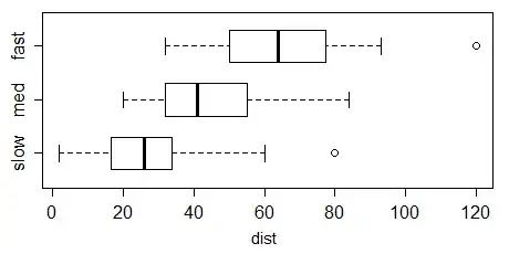

The usual (and original) definition of a box and whisker plot does include outliers (indeed, Tukey had two kinds of outlying points, which these days are often not distinguished).
Specifically, the ends of the whiskers in the Tukey boxplot go at the nearest observations inside the inner fences, which are generally at the upper hinge + 1.5 H-spreads and lower hinge - 1.5 H-spreads (basically, UQ + 1.5 IQR and LQ - 1.5 IQR). What's outside those is marked as outliers.
That's what R does, for example:
boxplot of stopping distances
There are many variations on the box plot, and some packages implement other things than the Tukey boxplot, but it's the most common one. Indeed, Wickham & Stryjewski's "40 years of boxplots" mentions numerous variations (and that's only a fraction of what can be found out there).
See Wikipedia's article on the box plot for some basic details.
Incidentally, Tableau isn't just showing outliers - it's showing all the data there. You can see it's marking points between the ends of the whiskers, and even points inside the boxes, not just the ones outside the inner fences.
Tableau describes its boxplots here; as you see the description broadly matches what I describe for Tukey boxplots above.

Tableau offers two options - Schematic box plot which is often referred to as Tukey box plot and skeletal box plot. Latter has whiskers extending from minimum to maximum. Former whiskers extending to the nearest data points within 1.5 IQR from the hinges. There is an option to toggle whether to show all points in the visualization or just the outliers.
  • I found it tough to track down the option for plotting the points other than outliers. You can get to it by right clicking the axis for the box plot's measure, selecting "Edit Reference Line", and then toggling "Hide underlying marks (except outliers)". – josliber Jul 22 '17 at 01:30
