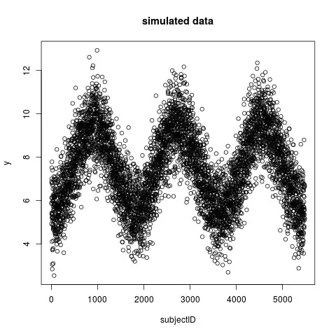

I simulated data a bit like yours, three years of daily data, 5 samples per day.

and generated a response by adding noise to a - b * cos(t):
y <- 7.5 + -2 * cos(seq(n)*2*pi/(365*5)) + rnorm(n,0,1)
The data have roughly the range and mean of yours, with a strong seasonal signal:
Form a data frame based on integer values and generate a month index:
d <- data.frame(sid=seq(n), month=as.POSIXlt(ts)$mon+1, y=round(y))
head(d)
  sid month y
1   1     1 7
2   2     1 5
3   3     1 6
4   4     1 6
5   5     1 6
6   6     1 5
Plot the response by month:
boxplot(y~month, data=d, xlab='month', ylab='y', main='simulated data')
This is roughly similar to your own, with a seasonal signal both stronger and clearer.
