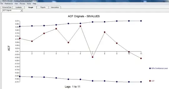

After receipt of data:
The ACF of your data does not initially (or finally) indicate any ARIMA process here BOTH ACF and PACF
and here just ACF:
image However there appears to be two level shifts in your data ... one at 1972 and the other at 1992 .. they appear to be nearly cancelling level shifts. A useful model might also include the incorporation of three unusual values at periods 1989,1959 and 1983. The equation then is image
