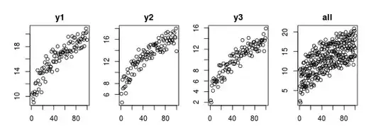

To illustrate with a reproducible example, say I have this data, D:
x = 1:100
y1 = 7 + 2 * x^0.4 + rnorm(100); plot(y1, main='y1')  # unit 1
y2 = 4 + 2 * x^0.4 + rnorm(100); plot(y2, main='y2')  # unit 2
y3 = 1 + 2 * x^0.4 + rnorm(100); plot(y3, main='y3')  # unit 3
D = data.frame(y=c(y1, y2, y3), id=rep(c(1,2,3), each=100), time=rep(x, 3))
plot(y ~ time, D, main='all')  # combined data

This gives me estimates like a=1.3 (it was 2), b=0.47 (it was 0.4) and k=5.4 (it was 1, 4 and 7). I'd like to do something like this:
