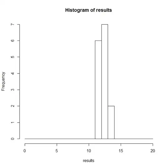

Say someone who is well practiced (appears to have reached a performance plateau) shoots 20 free throws on 15 different days and is successful the number of times shown in the upper histogram (dat in the code).
  1. My understanding is that the distribution of outcomes should be predicted by the binomial distribution. Is this correct?
  2. The expected variance is $np(1-p)$, where $n = 20$ (the number of trials per session) and $p = {\rm mean}/n =.65$ or the average percent of successes.
  3. I could not figure out how to theoretically calculate the distribution of sample variances, so ran a Monte Carlo simulation. These results are shown in the lower panel. the mean of these variances matches with the theoretical expected variance, but the variance of the data is much less.

I thought of another possible mechanism. The model below simulates a situation where the subject is "satisfied" after a threshold # of successes (here thresh=12). The output shown had variance=0.495. If this model were accurate, rather than performance, these experiments appear to measure some kind of motivation threshold. This would be completely different than measuring a skill level, and really alter how these results are interpreted. However, this model predicts many more successes at the beginning of the session than the end. While I do not have actual data recorded regarding this, the prediction is inconsistent with my memory/impression of what unfolded. If anything, I suspect the opposite would be true.

p.motivated=.9; p.unmotivated=.1; n=20; thresh=12; sessions=15
results<-matrix(nrow=sessions)
for(s in 1:sessions){
  session.dat<-matrix(nrow=n,0)
  for(t in 1:n){
    if(sum(session.dat)<thresh){
      session.dat[t]<-sample(c(0,1),1,prob=c(1-p.motivated,p.motivated))
    }else{
      session.dat[t]<-sample(c(0,1),1,prob=c(1-p.unmotivated,p.unmotivated))
  results[s]<-sum(session.dat)
hist(results,breaks=seq(0,20,by=1))
var(results)
Livid
