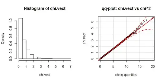

Here is a quick R demo: First I simulate the null hypothesis and show its distribution. Then I generate data where the null hypothesis is false and show the test. The data are three points drawn from normal distributions with means equal to $0$ (or they could have been anything else, so long as they are the same) and variances equal to $4$, $6$, and $8$. Thus the resulting mixture distribution variance is $18/3 = 6$. In this case there are three data points, so you have $2$ degrees of freedom.
set.seed(0884)                   # this makes the example reproducible
chi.vect = vector(length=10000)  # this will store the test statistics
for(i in 1:10000){               # I do this 10k times
  x  = c(rnorm(1,0,sd=sqrt(4)),  # here I generate the three data points
         rnorm(1,0,sd=sqrt(6)),
         rnorm(1,0,sd=sqrt(8)))
  vx = var(x)                    # this computes the variance of the sample
  chi.vect[i] = 2*vx / 6         # this computes the test statistic
enter code here
x   = c(rnorm(1, mean=30, sd=sqrt(4)),  # these data come from distributions
        rnorm(1, mean=20, sd=sqrt(6)),  #   w/ different means
        rnorm(1, mean=10, sd=sqrt(8)))  # x   = 29.26698 26.00434 13.89382
vx  = var(x)                            # vx  = 65.60725
chi = 2*vx / 6                          # chi = 21.86908
1-pchisq(chi, df=2)                     # p   =  1.783157e-05

The qqplot gung has provided appears correct. But the plotted points do not closely follow y = x! This should be the case if the distribution was actually chi-squared. Here's a qqplot including the line y=x generated from the following code (adapted from gung's answer):
qqplot - chi-squared
# Generates the q-q plot comparing the theoretical
# chi-squared distribution to the empirical distribution
# of the randomly sampled values:
empirical_quantiles = chi.vect[order(chi.vect)]
empirical_cdf = c(1:length(chi.vect))/length(chi.vect)
exact_quantiles = qchisq(empirical_cdf,df = 2)
plot(exact_quantiles,empirical_quantiles)
abline(0,1, col="red")
