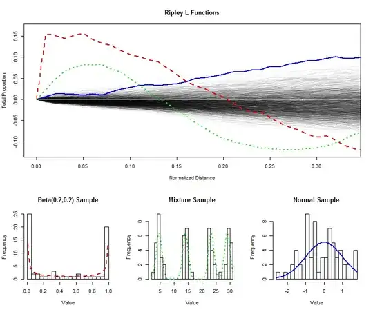

To illustrate, I have simulated $999$ independent samples of size $64$ from a uniform distribution and plotted their (normalized) L functions for shorter distances (from $0$ to $1/3$), thereby creating an envelope to estimate the sampling distribution of the L function. (Plotted points well within this envelope cannot be significantly distinguished from uniformity.) Over this I have plotted the L functions for samples of the same size from a U-shaped distribution, a mixture distribution with four obvious components, and a standard Normal distribution. The histograms of these samples (and of their parent distributions) are shown for reference, using line symbols to match those of the L functions.
The sharp separated spikes of the U-shaped distribution (dashed red line, leftmost histogram) create clusters of closely spaced values. This is reflected by a very large slope in the L function at $0$. The L function then decreases, eventually becoming negative to reflect the gaps at intermediate distances.
The sample from the normal distribution (solid blue line, rightmost histogram) is fairly close to uniformly distributed. Accordingly, its L function does not depart from $0$ quickly. However, by distances of $0.10$ or so, it has risen sufficiently above the envelope to signal a slight tendency to cluster. The continued rise across intermediate distances indicates the clustering is diffuse and widespread (not confined to some isolated peaks).
The initial large slope for the sample from the mixture distribution (middle histogram) reveals clustering at small distances (less than $0.15$). By dropping to negative levels, it signals separation at intermediate distances. Comparing this to the U-shaped distribution's L function is revealing: the slopes at $0$, the amounts by which these curves rise above $0$, and the rates at which they eventually descend back to $0$ all provide information about the nature of the clustering present in the data. Any of these characteristics could be chosen as a single measure of "evenness" to suit a particular application.
These examples show how an L-function can be examined to evaluate departures of the data from uniformity ("evenness") and how quantitative information about the scale and nature of the departures can be extracted from it.
(One can indeed plot the entire L function, extending to the full normalized distance of $1$, to assess large-scale departures from uniformity. Ordinarily, though, assessing the behavior of the data at smaller distances is of greater importance.)

R code to generate this figure follows. It starts by defining functions to compute K and L. It creates a capability to simulate from a mixture distribution. Then it generates the simulated data and makes the plots.

layout(matrix(c(rep(1,3), 3, 4, 2), 2, 3, byrow=TRUE), heights=c(0.6, 0.4))
# Display the L functions over an envelope for the uniform distribution.
plot(c(0,1/3), c(-1/8,1/6), type="n",
xlab="Normalized Distance", ylab="Total Proportion",
main="Ripley L Functions")
invisible(replicate(999, {
plot(Ripley.L(x.unif <- runif(n)), col="#00000010", add=TRUE)
abline(h=0, lwd=2, col="White")
# Each of these lines generates a random set of `n` data according to a specified
# distribution, calls `Ripley.L`, and plots its values.
plot(Ripley.L(x.norm <- rnorm(n)), col="Blue", lwd=2, add=TRUE)
plot(Ripley.L(x.beta <- rbeta(n, alpha, beta)), col="Red", lwd=2, lty=2, add=TRUE)
plot(Ripley.L(x.mixture <- rmixture(n, p, f)), col="Green", lwd=2, lty=3, add=TRUE)
# Display the histograms.
n.breaks <- 24
h <- hist(x.norm, main="Normal Sample", breaks=n.breaks, xlab="Value")
curve(dnorm(x)*n*mean(diff(h$breaks)), add=TRUE, lwd=2, col="Blue")
h <- hist(x.beta, main=paste0("Beta(", alpha, ",", beta, ") Sample"),
curve(dbeta(x, alpha, beta)*n*mean(diff(h$breaks)), add=TRUE, lwd=2, lty=2, col="Red")
h <- hist(x.mixture, main="Mixture Sample", breaks=n.breaks, xlab="Value")
curve(dmixture(x, p, g)*n*mean(diff(h$breaks)), add=TRUE, lwd=2, lty=3, col="Green")
