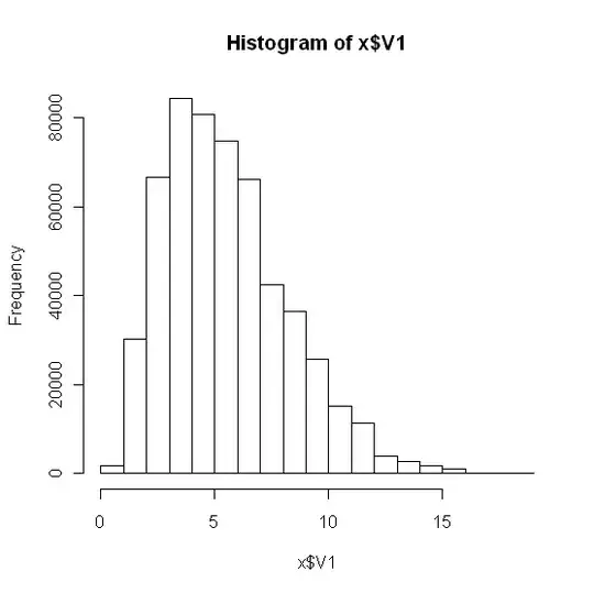

I have a large dataset (500000 data, V1 column include all the data).
x <- read.csv("mydata.csv", header=F)
hist(x)
Which gives:
Histogram
Looking at the data, I believe it is not a normal distribution. As a further check, I constructed a qqplot:

All I can say is that your eyes are one of your better EDA tools. If your data (with 500,000 observations) doesn't look normal, then there's no reason to even perform a statistical test for normality. Especially with that many data points, any slight deviation from normality should make you fail the test.
It looks like your data is actually discrete, too. You should consider fitting a Binomial or Poisson or some other discrete distribution to the data.
  • Thanks Max. Could you mind to let me know where can i find how does other distribution should look like? As I have not much experience that I cannot tell which population does it look like when I look at the population chart 1. – evdstat Jun 23 '11 at 07:06

    I probably shouldn't have told you your data looks discrete without actually seeing some of the numbers. Would you mind posting a summary/example of the data you're working with? – assumednormal Jun 23 '11 at 13:27
I would not rely on p-values for any test of normality (or for much else, frankly). Look at the graphs.
You can, a priori, say that EVERY distribution is non-normal. If you have a large dataset the nonnormality will be statistically significant. The questions are HOW non-normal? Non-normal in what ways? and What are the consequences?
None of these questions is answered by any test of normality or statistical significance.
