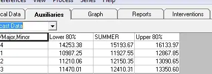

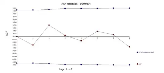

You might look very closely at my response to Seeking certain type of ARIMA explanation
UPON RECEIPT OF DATA (enter image description here :some 27 quarterly observations starting at 2008 q1
The ACF of the original series suggests a fairly strong seasonal structure. AUTOBOX automatically identified a model enter image description here and shown here enter image description here which yielded an ACF of the error process suggesting model sufficiency enter image description here . The model includes an identified intervention at period 21 (2013 quarter 1 ) of the 27 observations. A plot of the actual and the cleansed highlights the anomaly.enter image description here The actual/fit/forecast graph is here enter image description here with forecasts here enter image description here. In summary there was no need for any variance stabilization transformation for this data set. The optimal box-cox coefficient requires a model and in this case is 1.0. If you don't specify a model as is possible with boxcoxfit then in the absence of a good ARIMA structure and the identified anomaly at period 21 you might then get a lambda like .52 which is probably the result of an incorrect model.

  • so is this suitable to apply to any series even if it may not need transforming? – Summer-Jade Gleek'away Oct 27 '14 at 15:07
  • Yes because if the error process is free of any of the structure I referenced then the conclusion will be No Transform is required. – IrishStat Oct 27 '14 at 15:09
  • ok great, so i can apply that to my code so everything automates :) thankyou :) – Summer-Jade Gleek'away Oct 27 '14 at 15:12
  • Just be careful that the error term from your model is free of ARIMA structure , Free of any Pulses/level-Step shifts , Local Time Trends and Pulses AND that you have verified t hat the model parameters are invariant over time OTHERWISE you may be pinning the tail on the wrong donkey . – IrishStat Oct 27 '14 at 15:18
