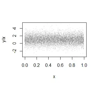

As a check, we may simulate a large number of independent realizations of $(X,Y)$ and plot them. The following carries this out with R:
n <- 1e4
x <- runif(n)
y <- rnorm(n, x, x)
plot(x, y/x, cex=1/3, col="#00000020")
Figure
In any vertical slice the distributions of the $y_i/x_i$ look approximately the same. (They are all standard Normal with mean $1$, as we can see from their PDF $\phi(z-1)$.) That is what independence of $Z$ and $X$ means: the distribution of $Z$ does not vary with the value of $X$ (nor does the distribution $X$ vary with the value of $Z$).
