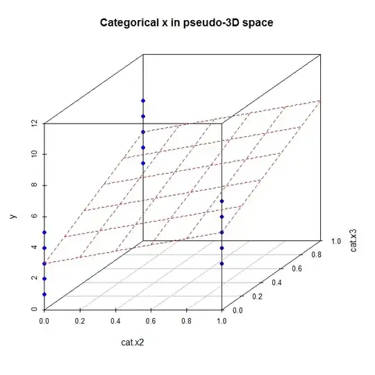

(@Nick Cox has done a good job talking about the issues involved in combining levels of a factor; I thought I would explain a little bit about categorical variables.)
It is not possible to 'fit a curve' to a categorical (nominal) variable. Nor is it possible to 'smooth' the fit. There are many ways to represent / code a factor (also here). Nonetheless, in one way or another, all methods use $k$ degrees of freedom to represent $k$ groups. In the end, the groups are fit by finding $k$ group means. By contrast, it is possible to have $k$ groups at fixed locations along a single, continuous variable (such as $0$ mg, $10$ mg, $20$ mg, etc.). In that case, a single degree of freedom can be expended to fit a straight line, or more for curved functions (e.g., $2$ for a curve with a single 'bend'). The implication of using $k$ degrees of freedom for $k$ groups is that each group is placed on its own dimension in the model's space. With, at most, $2$ groups on any dimension, curved functions are not meaningful. Thus, the reason you cannot find any R packages to do this is because it cannot be done. To illustrate, consider the following:

The continuous x is represented by a single variable. In the model fit, the slope of its line is given and the intercept is just the y value where the line crosses x=0. For the categorical x, it's different:

A separate variable is created for x=2 and for x=3, x=1 is indicated by 0's in both of those variables. In the model fit, the intercept now represents the mean of the first group, and the following two variables give the difference between the latter groups (each individually) and the first group.
Here are some pictures of what they look like:
