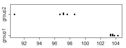

# strip chart:

Those are all about as consistent with each other as I would expect on that data.
