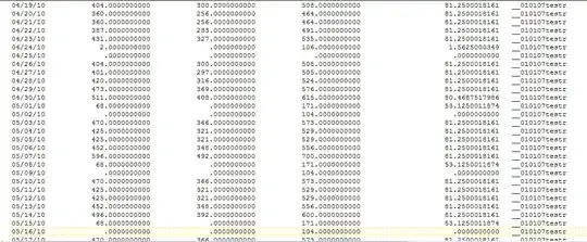

You data https://www.autobox.com/FATEME/TestData.xlsx is here . I suggest other readers take the data and try to analyze it. On first view the 1096 historical daily values appear to have a large number of "outliers". These unusual values are in effect mostly usual as certain holidays have a significant effect. The problem you are having has to with your design matrix. You assume that the effect is day-of-the-week vs weekend. This is wrong because each day has it's own effect and certainly the 5 work days are not equal and the two weekend days are not equal in their importance. There have been major shifts in the days-of-the=week effects. Furthermore specific days-of-the-month and specific months of the year are very important in addition to Friday before Holidays impacts. Next there is a visually obvious level shift ( on or about 1/27/09 ) in your data that needs to be accounted for such that the final model coefficients are robust and meaningful.
Using AUTOBOX (a piece of software available from http://www.autobox.com/cms/ which I have helped develop) in a totally automatic fashion a model containing both deterministic effects and memory (ARIMA) was forged.
Attached is the equation (in two parts)enter image description here and enter image description here. A test for the sufficiency of a model is the ACF of the errors suggests randomness. Following is the Forecast plot.enter image description here. I have added a representativeenter image description here screen shot of the forecasts presented in tabular fashion (forecasts then lower limit then upper limit).
With apologies in advance the 1096 values were able to be characterized with 58 statistically significant coefficients.
The summary statistics from the model are as follows enter image description here
EDIT: I have added the 366 forecasts from 1 origin 12/31/2009 https://www.autobox.com/FATEME/AB50PRO.123
