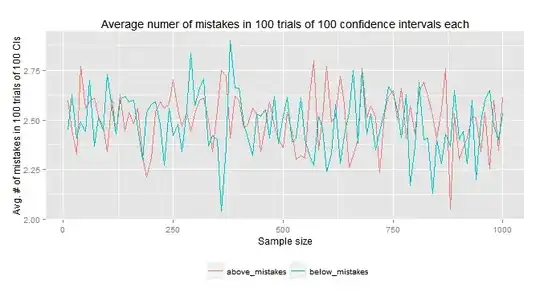

UPDATE: After very useful comments from @swmo and @heropup I re-run the exercise, now taking samples from the whole distribution instead of samples from a finite population, so as to have truly independent samples.
And this is the result: pretty much what you would expect in the first place. i) no considerable differences in above and below mistakes and ii) total number of CIs that do not include the true parameter (above+below mistakes) close to 5%.
updates exercise

    The results you show in your plots don't make sense to me, especially the lower two plots. If you calculate a $100(1-\alpha)%$ CI for normally distributed data using either a normal or t distributed sampling distribution, all distributions involved are symmetric and therefore the CI will be equally likely to overestimate the true mean as it is to underestimate it. Moreover, this property should be independent of the sample size for a fixed $\alpha$ level. – heropup Sep 15 '14 at 22:36
  • Thanks for the comment. Yeah, that's exactly my question. Indeed I expected the "CI [to] be equally likely to overestimate the true mean as it is to underestimate it", but the results does not show that. Of course, my first thought was "I am doing something wrong" and then I checked my code literally a thousand times (well, not literally 1k, but surely many many times) and I could not find anything wrong. My last test was to use R built-in function to calculate the confidence interval and compare it with the CI calculated "by hand" and they are always exactly the same. – Hernando Casas Sep 16 '14 at 05:00
    Your checking might not take into account methodological errors. When I performed a simulation of my own, using Mathematica, my empirical results demonstrated that, in fact, underestimation and overestimation occurred with roughly equal frequency for symmetric distributions, and was constant across sample size. I have not taken a close look at your R code. – heropup Sep 16 '14 at 05:15
First of all, I agree with the comments left by heropup. I'll add some details.
The reason why your simulation breaks down may be a little subtle. At least I spend some time reading your code to find the source of the problem. Please notice, that you only simulate once for each of the cases. Then your CIs functions resample this initial data set. This clearly gives a lot of dependence between all of the samples. For instance, if you draw a sample of 1000 of the original data set, there is only one way to do this. If you draw a sample of 999 an overwhelming majority of the data set will still be the same between resamples. You'll need to do independent resampling. Otherwise, the 100 samples are essentially the same when you let $n$ get large.
Turning to your question, a confidence interval as the ones you do above are based on a distributional assumption, for instance your observations are normally distributed. If that's the case the confidence interval will be 'centered' in the sense you talk about when you construct the confidence interval symmetrically. This is evident from the symmetry of the distribution and of the procedure of constructing a confidence interval. In the above, you also calculate a confidence interval when the distributional assumption you make is not correct. Then an confidence interval need not be centered, even if the distribution assumed is symmetric. This can be seen simulated observations from a chi squared distribution and calculating confidence intervals based on a normal distribution. However, using a central limit theorem we can argue that the mean of the chi squared observations will be approximately normally distributed for large enough sample sizes.
Finally, I just want to note that a confidence interval (or more generally, a confidence set) is basically and loosely speaking just some subset of a parameter set such that when you calculate this set a lot of times (hypothetically) it will contain the true parameter value for example 95% of the times. There's no claim of this set being 'centered' or symmetric around a parameter estimate. It can be chosen to have all sorts of strange forms. This is just not very intuitive and most of the time not very helpful.
swmo
  • 2,242
  • Many thanks.I wanted to simulate what you say in your last paragraph in the sense that if you calculate the CI "a lot of times (hypothetically) it will contain the true parameter value for example 95% of the times". That is why the CI functions calculate the CI many times (num_CIs=100), each of them using a different sample of the same population. Since it is a new sample every time, I assumed them independent of each other; after your comment I see the dependency, but how can I do it differently? it seems to me that this dependency arises as a result of sampling the same population, isn't it? – Hernando Casas Sep 16 '14 at 10:31
  • Yes, if you sample the same finite population as you do, there'll be that kind of dependency. But if you just recall e.g. ${\tt rchisq }$ each time to make independent samples, there'll be no problem. You want to estimate the probability of getting a confidence interval that contains the true parameter. This should be done using independent samples as you are basically using the law of large numbers to estimate a probability (the mean of a indicator function). – swmo Sep 16 '14 at 10:46
  • As you say, I expected 95 out the 100 CIs to contain the true parameter. And they actually do roughly in those proportions (when the distributional assumption holds or when it does not hold but the central limit theorem kick-in). And this was actually the original motivation for my exercise, but then I found this discrepancy between the below and above mistakes, and I cannot seem to get a handle on it. – Hernando Casas Sep 16 '14 at 10:46
  • Thanks again, ..., one question. Recalling rchisq would be like generating a new universe (finite population). isn't it? I thought that to simulate the concept of a CI, the best way would be to take many -seemingly independent- samples from the same population. But yeah, maybe the way to think on this would be to take the whole distribution to be the population. I will try that. – Hernando Casas Sep 16 '14 at 10:51
  • Many many thanks, ..., I cannot vote because I am new here and my reputation is still not high enough, but I really appreciate your answer and comments. I'll work on it and I'll post my new results later. – Hernando Casas Sep 16 '14 at 10:53
  • Think about it this way: there is a true and unknown distribution of some stochastic variables. We want to estimate probability of some event concerning these variables (in our case something about a CI). For that we need independent samples from this distribution. If we have that we can use the law of large numbers to estimate the probability of the event. This is why we need to use independent sampling. – swmo Sep 16 '14 at 10:58
  • Many thanks again. It was really really helpful. Very best. – Hernando Casas Sep 16 '14 at 19:50
