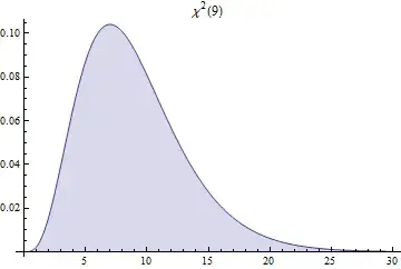

We can reverse-engineer the problem from the graphics and information helpfully posted in the question. Because there are $41000$ data and a bin width of $45$ km/s, the second graphic must have been obtained by multiplying the counts in the first by $\lambda \approx 1/(41000\times 45) = 5.42\times 10^{-6}$. As a check, that should have changed the highest bar in the first histogram from around $9500$ to about $0.0051$ in the lower--and that looks exactly right. Thus, the original $\chi^2$ statistic of $85.06$ (reported at the top of the first graphic) was changed (incorrectly) to $85.06\times 5.5\times 10^{-6}=0.0000461$, exactly as reported at the top of the second graphic.
Although no information is supplied about the degrees of freedom (the number of bins used), we can ascertain that it is well below $85$ (for otherwise the original $\chi^2$ statistic would have a p-value measurably greater than the reported value of $0.000$). Moreover, the df must be at least $1$. It's likely a little less than the number of bins spanning the histograms, of which there are between $10$ and $20$. For any $\chi^2$ distribution with df in that range, a value of $0.0000461$ or greater is almost certain, resulting in the reported p-value of $1.000$ in the lower graphic.
Figure
Normalizing the data changed the $\chi^2$ statistic from $85$ to $4.6\times 10^{-5}$. The p-value is the area under a curve like this one to the right of the statistic. That area shifted from essentially zero to essentially one, completely changing the answer.
