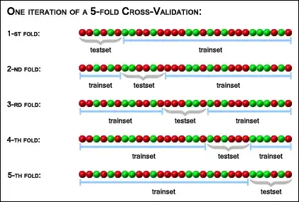

1) How many records of the 9000 should I use to train the network? 1a. Should I completely randomize the selection of this training data or be more involved and make sure I include a variety of output scores and a wide range of each of the input variables?
I would recommend that you read about cross-validation here. The concept is not mathematically heavy. The below figure may be useful to illustrate: enter image description here
With regards to the selection of your subsets for cross-validation, I suspect the 9000 samples span quite a few years, over which the effects of different random variables on your outcome may have changed. I would suggest that you pay attention that each sub-set is homogeneously spread-out along the interval, rather than the first subset consisting exclusively of 1999 records, whereas the final one only contains 2014 records.
2) If I split the data into an even number, say 9×1000 (or however many) and created a network for each one, then tested the results of each of these 9 on the other 8 sets to see which had the lowest MSE across the samples, would this be a valid way to "choose" the best network if I wanted to predict the scores for my incoming students (not included in this data at all)?
After reading the cross-validation link above, I recommend that you have a look at @Dikran Marsupial's answer here. The summary is you should use the full data set to come up with the final model.
