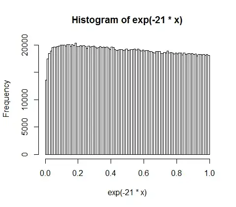

But for n=20, it starts to look pretty close; in fact as $n$ grows large it will be well approximated by an exponential with mean $\frac{1}{n+1}$.
If that was actually exponential with mean 1/21, then $\exp(-21x)$ would be uniform... but we can see it isn't, quite:
The non-uniformity in the low values there corresponds to large values of the gaps -- which we'd expect from teh above discussion, because the effect of the "cutting off" the Poisson process to a finite interval means we don't see the largest gaps. But as you take more and more values, that goes further out into the tail, and so the result starts to look more nearly uniform. At $n=10000$, the equivalent display would be harder to distinguish from uniform - the gaps (representing shares of the money) should be very close to exponentially distributed except at the very unlikely, very very largest values.

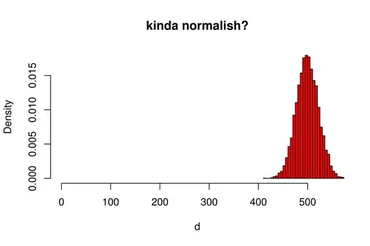

Method 3:
Start with 'p' 0s. w times, add 1 to a one of them, selected uniformly at random.
d <- rep(0, p)
for( i in 1:5000000){ ## for-loops in R are terrible, but this gives the idea.
    k <- floor(runif(1, max=p)) + 1
    d[k] = (d[k] + 1)
h <- hist(d, col="red", main="kinda normalish?", freq = FALSE, breaks = 45,
          xlim = c(0, quantile(d, 0.99)))
iterative dollars
