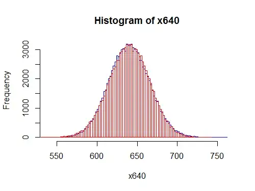

Very slightly skew. This skewness decreases as the square root of the sample size. So at n=160, it's half as skew. At n=640 it's one quarter as skew:
That this is effectively symmetric can be seen by flipping it over about the mean and plotting it over the top:
Blue is the original, red is flipped. As you see, they're almost coincidental.
