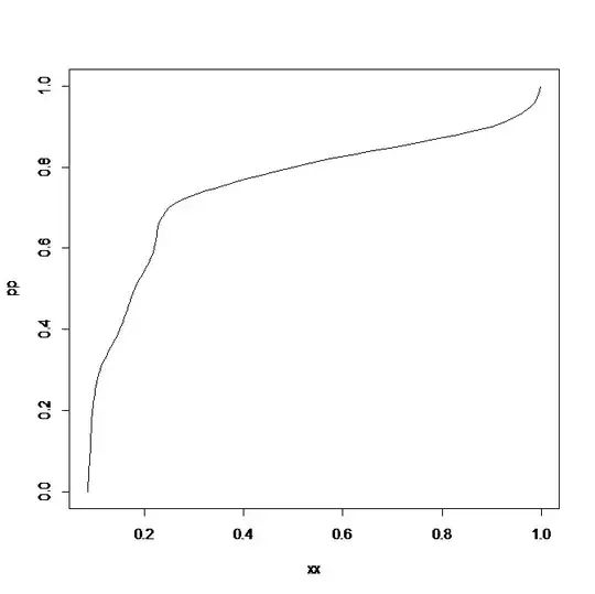

You can plot these function in R. Then make a more densely populated table, and use it to plot the inverse function $F(x)$:
> pp  <-  seq(0,1,by=0.01)
> xx <-  Q(pp)
> plot(xx,pp,type="l")
Gives the following plot of the cumulative distribution function:
You could continue, for example using numerical differentiation to find the density, but that I leave for you. From this data we can calculate the expextation of $X$, $\mu=\text{E}(X)$. We use the formula for non-negative random variables $$ \mu = \int_0^\infty (1-F(t))\; dt $$ (which in our case reduces to an integral from zero to one because $1-F(t)$ is zero for $t$ larger than one.) In R we can approximate this as
mu <- sum((1-pp))*0.01 mu 1 0.505
When matching to a beta distribution with parameters $a,b$ (refer to wikipedia) we can use then the result that $\mu = \frac{a}{a+b}$, resulting in the choice $a=1.02 b$, or approximately $a=b$. Then you can plot beta distributions for various choices of $a$ ($b$) and see if it matches.
